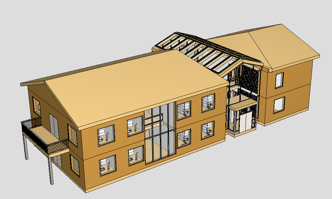

  1. First, we need a model. This is the model I am going to use in this example to add location information and split it.

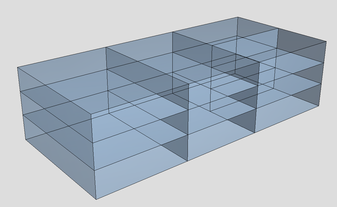

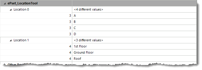

  2. Next, we need the location prisms. These prisms are in a separate IFC file, and each prism contains location information that we will copy to the objects inside the prism.

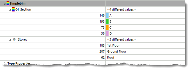

    This is the location information that we need. We are going to copy the property values from “Location 0” and “Location 1” to the objects inside the prism.

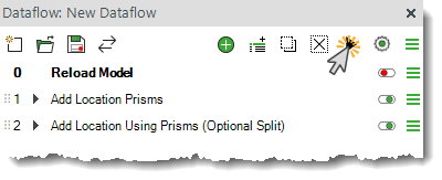

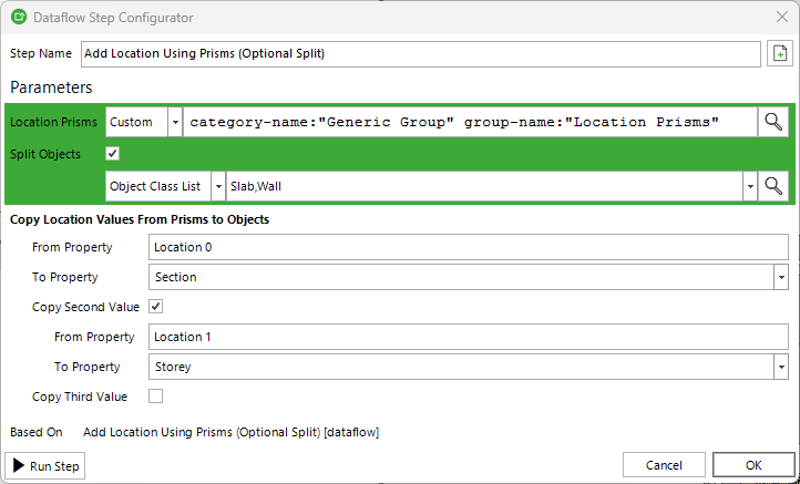

  3. Then we need to configure the dataflow. For this task, we only need two steps.

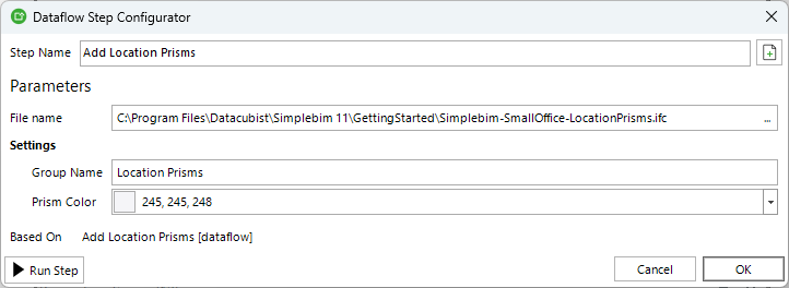

    1. The first step is the “Add Location Prisms” step. This step imports the location prisms from the IFC file that contains them and groups the prisms into the “Location Prisms” group. You can also set the visual appearance for the location prisms if needed. You can read more about the configuration options in this support article: Dataflow Add Location Prisms
    2. The second step is the “Add Location Using Prisms (Optional Split)” step. This step adds the location information to the objects by copying the property values from the location prisms to the objects. By default, it uses the objects in the “Location Prisms” group that the previous step generates. In this example, I enable the “Split Objects” option to split objects in the “Slab” and “Wall” object classes based on the location prism geometry. You could also use object groups or object selections as the objects to split, if needed. You can read more about the configuration options in this support article: Add Location Using Prisms Optional Split
  4. Now we are ready to run the dataflow we created.

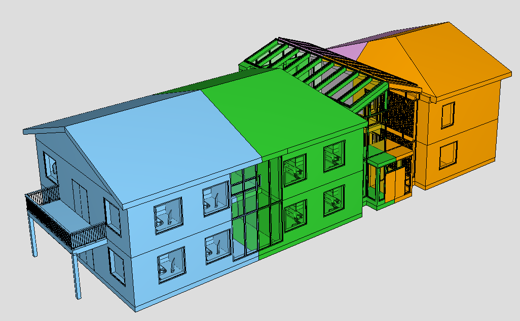

  5. This is the final result, colorized based on the section.
