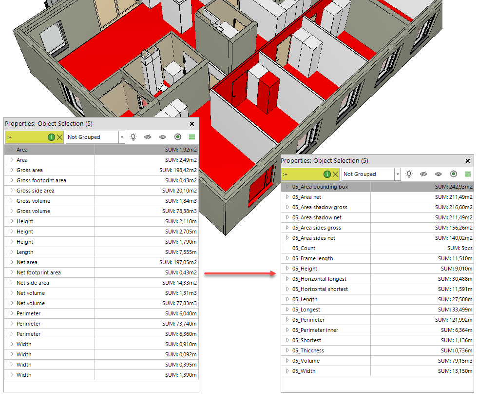

Working with original quantities can be frustrating (properties on the left). Selecting multiple object classes quickly reveals the problem: quantities with the same property name may appear multiple times in an IFC model. You need to know which one to use for each object — and the correct one may vary from project to project. Resolving this takes time and requires solid BIM skills. The enriched standard property set structure (properties on the right) is consistent across all objects. The same quantity properties are always in the same place, with the same names. This makes it possible to use standard take-off reports.

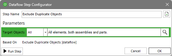

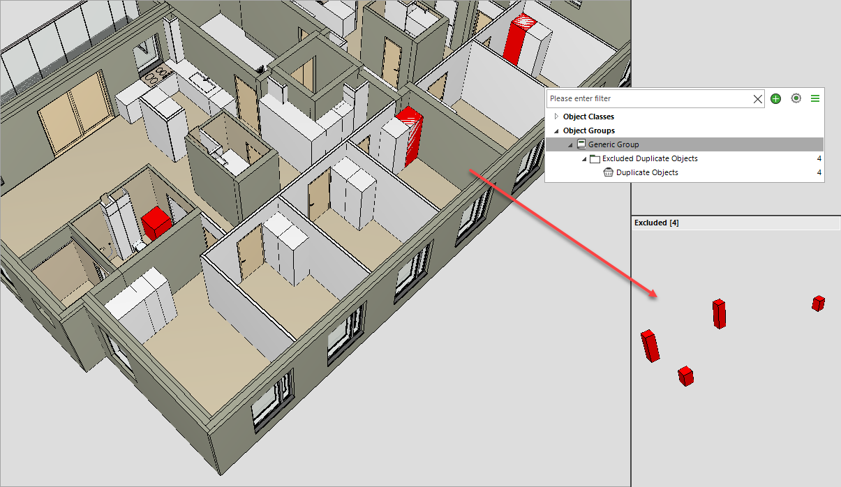

The first step, Exclude Duplicate Objects, automatically scans the selected target objects, identifies geometrically duplicate objects, and moves them to the Excluded window. The only required configuration is selecting the target objects. If the target is not changed, the entire model will be checked.

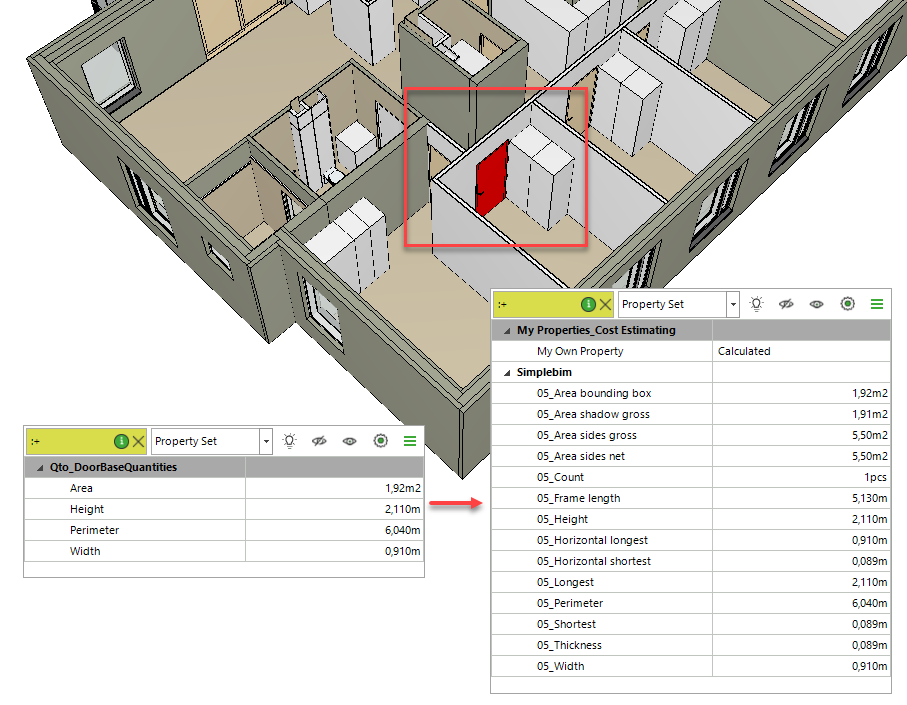

The second step, Add Basic Quantities, automatically calculates geometry-based dimensions and quantities for all objects in the model (excluding those in the Excluded window). Property names and structure remain consistent across all object classes and disciplines, while the selection of quantity properties is based on object class. All quantity properties are added to the Simplebim property set.

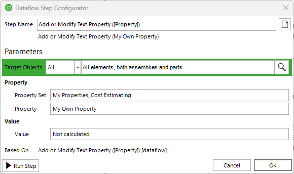

The third step, Add or Modify Text Property, adds a new property to the selected target objects. You can define both the property set name and the property name. You can also assign a default value to the target objects. In this case, I create a property set called My Properties_Cost Estimating and a property called My Own Property with the default value Not calculated. This property can be used, for example, to mark objects that have already been included in the calculations or to store other relevant information in the IFC objects.

  • Duplicate objects grouped and moved to the Excluded window

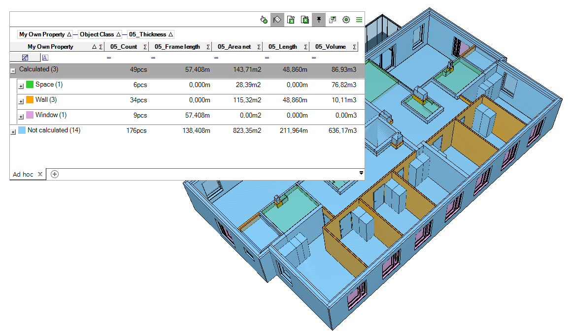

Select objects and use your custom property for notes such as “Calculated”, “Done”, etc.
Group, report, and calculate quantities:
  • By your custom property
  • By building storey
  • By object class
Use your custom property in 3D visualizations to show:
  • Work progress
  • Your method of organizing quantities
