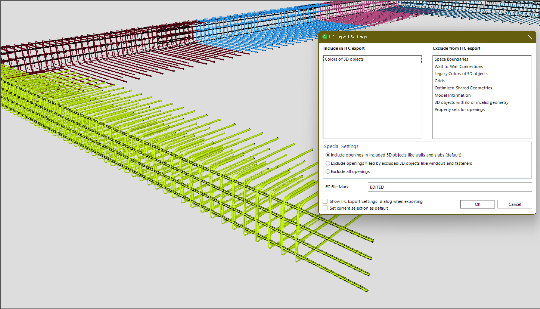

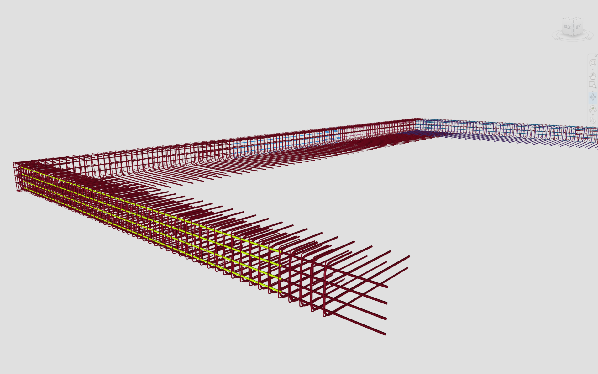

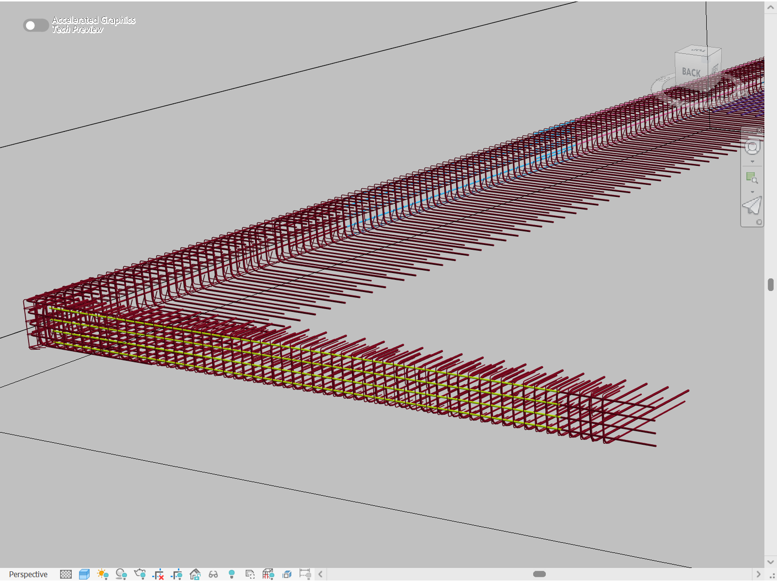

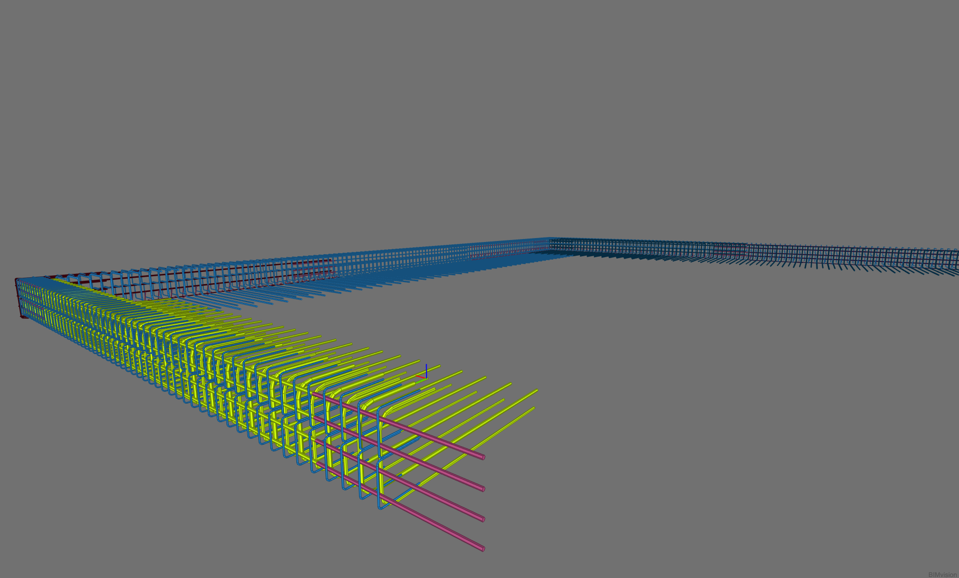

I've used Simplebim to change colour of some objects and exported the IFC. The problem is when I open the IFC in other IFC viewers, the colour isn't the same as what I have specified in Simplebim.
Fig 1: Object colours as seen in simplebim (with export settings)
Fig 2: Object colours as seen in Navisworks
Fig 3: Object colours as seen in BIMvision
Fig 4: Object colours as seen in Revit

    One thing that might be worth trying is using the "Legacy Colors of 3D Objects" export option instead of the "Colors of 3D Objects" option. It uses an older encoding, which might work better with some applications.
