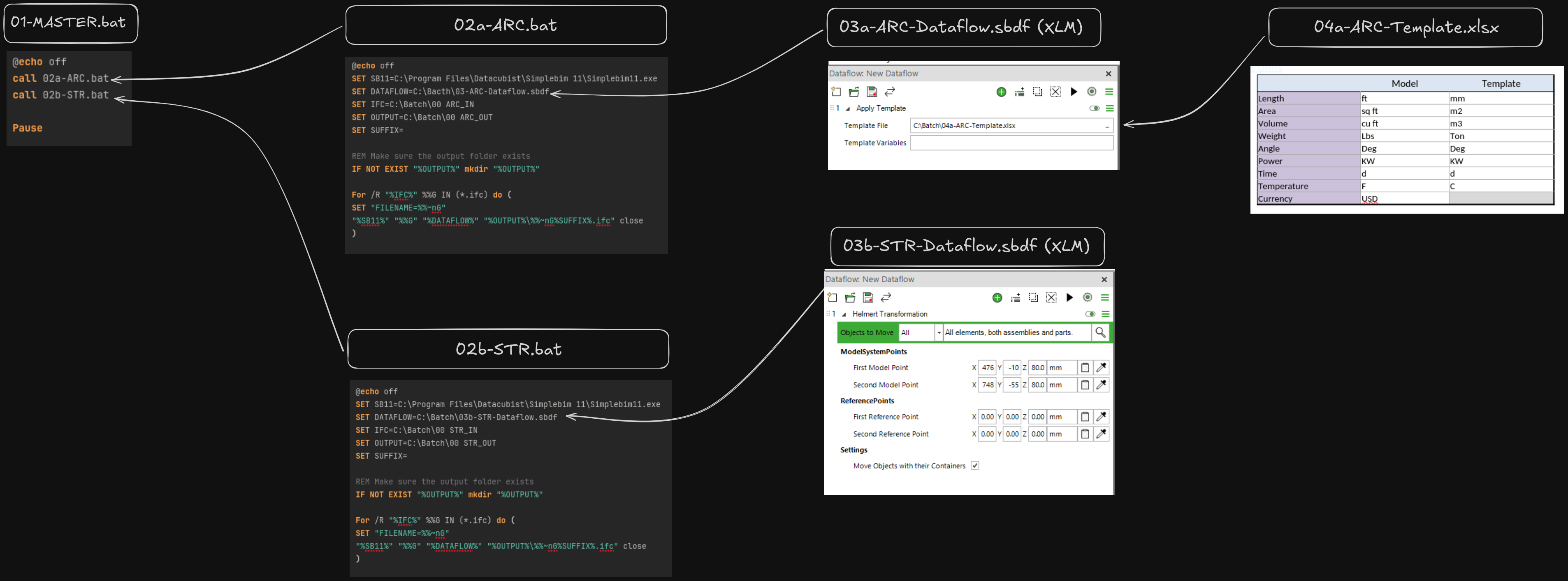

Inspired by Gio's Running dataflows from the command line.
String a number of command line executions to deal with different discipline models requiring individualised processing.
Master.bat:
@echo off
call 02a-ARC.bat
call 02b-STR.bat
Pause
02a-ARC.bat (similar to 02b-STR.bat):
@echo off
SET SB11=C:\Program Files\Datacubist\Simplebim 11\Simplebim11.exe
SET DATAFLOW=C:\Bacth\03-ARC-Dataflow.sbdf
SET IFC=C:\Batch\00 ARC_IN
SET OUTPUT=C:\Batch\00 ARC_OUT
SET SUFFIX=
REM Make sure the output folder exists
IF NOT EXIST "%OUTPUT%" mkdir “%OUTPUT%”
For /R "%IFC%" %%G IN (*.ifc) do (
SET "FILENAME=%%~nG"
"%SB11%" "%%G" "%DATAFLOW%" "%OUTPUT%\%%~nG%SUFFIX%.ifc" close

    Is each step is started after the previous one completes? If yes, then this will work. The limitation is that you can't start multiple Simplebim ‘runs’ at the same time; the next one can be started after the previous has completed.

    Each step is completed, before following command is launched with only one instance of SimpleBIM running. This was tested and worked like a treat. Hope this helps others in the community where bulk processing of different design disciplines is required, regardless of the number of models in question.
