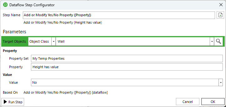

  1. First, we create a boolean property called "Height has value" in the "My Temp Properties" property set and set the default value to "No".

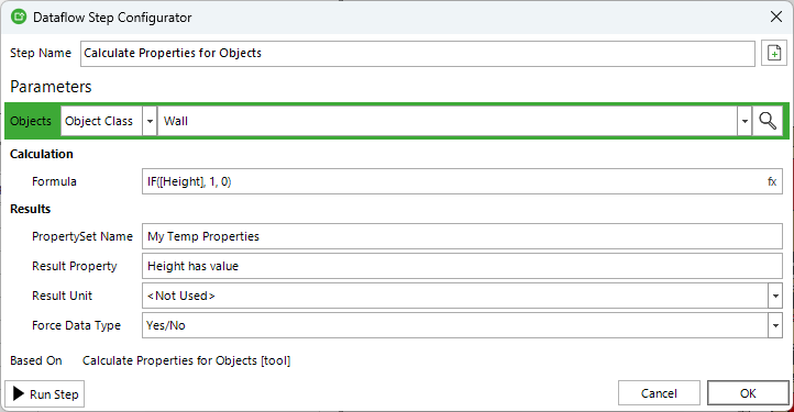

  2. Next, we use the "Calculate Properties for Objects" step to set the "Height has value" property to "Yes" for objects that have a measure property value for the "Height" property.

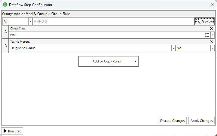

  3. Finally, create a group based on the temporary property that was created.
