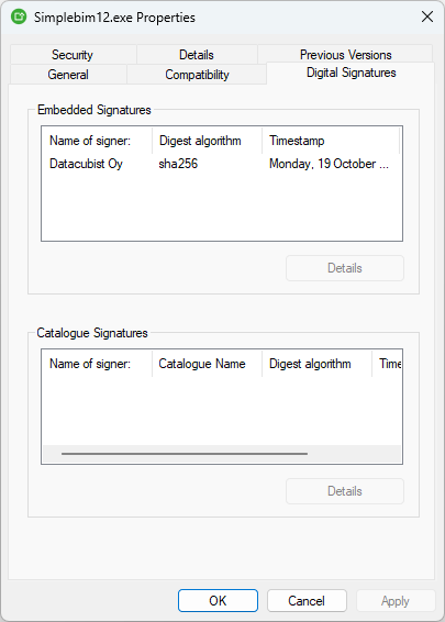

  1. In File Explorer, right-click the file (for example Simplebim12.exe) and choose Properties.
  2. Open the Digital Signatures tab. If the tab is missing, the file carries no signature at all. See If the Check Fails.
  3. In the Signature list, the Name of signer must read Datacubist Oy.

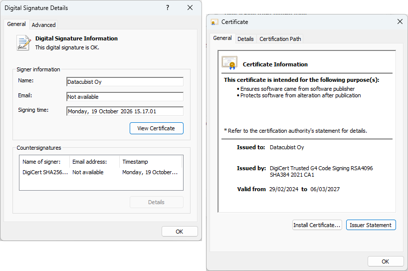

  4. Select that row and click Details. The dialog must say This digital signature is OK.
  5. Optional: click View Certificate. Issued to must be Datacubist Oy and Issued by must be a DigiCert code signing CA.
Any other signer name, a missing tab, or a dialog that reports the signature as not valid means the file is not a genuine, unmodified Datacubist file.

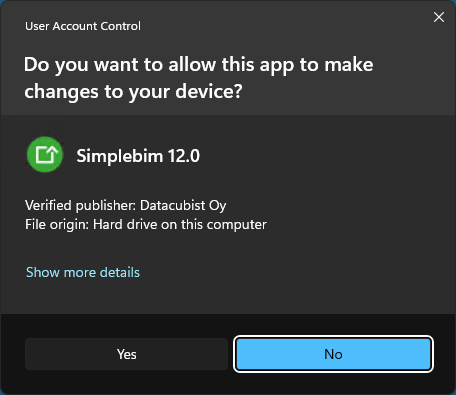

The installer is signed the same way. When you start it, the Windows User Account Control prompt shows Verified publisher: Datacubist Oy. An installer that shows Unknown publisher instead has not come from Datacubist unchanged.
