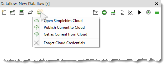

Where You Find the Dialogs
The Cloud button on the toolbar of the Dataflow palette drops down a menu.
Open Simplebim Cloud opens the Simplebim Cloud web application in your browser.
Publish Current to Cloud opens the Publish Dataflow to Simplebim Cloud dialog for the dataflow that is currently open in the palette.
Get as Current from Cloud opens the Get Dataflow from Simplebim Cloud dialog. The fetched dataflow replaces the current dataflow in the palette.
Forget Cloud Credentials is shown only while a sign-in is saved on this computer. It removes the saved sign-in. See Signing Out and Forgetting the Sign-in.

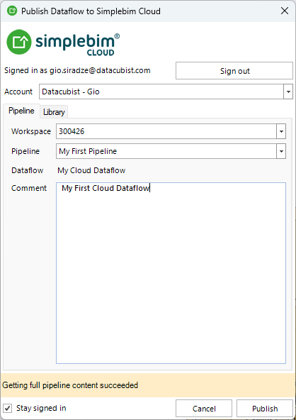

The Dialog at a Glance
From top to bottom the dialog has the following parts.
Sign-in line shows the Simplebim Cloud logo, the text Not signed in or Signed in as you@example.com, and the Sign in to Cloud button, which becomes Sign out once you are signed in.
Account is the account you are working in. Enabled after sign-in.
Pipeline and Library tabs decide where the dataflow goes to or comes from. Each tab has its own fields, described below.
Status line tells you what the dialog is doing — Getting workspaces for the account 'Acme', please wait... — and why something failed. Read it first when a button stays grey.
Stay signed in decides whether the sign-in is kept for the next time. See Staying Signed In.
Cancel closes the dialog without publishing or getting anything.
Publish or Get performs the action on the tab that is currently visible. Grey until everything it needs has been chosen.
While the dialog talks to the cloud the cursor shows an hourglass and the status line says please wait. Every drop-down is filled from the cloud one level at a time, so there is a short pause after each choice.

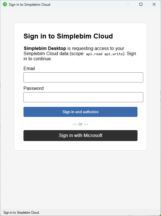

The Sign-in Window
Sign in to Cloud opens the Sign in to Simplebim Cloud window. It is a small built-in browser that shows the sign-in page of Simplebim Cloud — the same page you would see in your web browser. The page offers two ways in:
  • your Simplebim Cloud e-mail address and password;
  • Sign in with Microsoft, for organisations whose users sign in with their Microsoft work account. For some organisations this is the only way in.
When the page accepts you the window closes on its own and the dialog shows Signed in as your e-mail address. If the page refuses you, a Sign-in failed message tells you why, the sign-in page is loaded again and you can try again. Close the window to give up; the dialog then stays signed out.
The built-in browser needs the Microsoft Edge WebView2 Runtime, which is normally already installed with Windows. Without it the window reports Could not start the sign-in browser and closes.

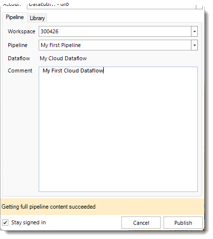

The Pipeline Tab
Workspace
The workspace in the chosen account. Selected for you when there is only one. The same when publishing and when getting.
Pipeline
The pipeline in the chosen workspace. Selected for you when there is only one. The same when publishing and when getting.
Dataflow
When publishing: the name of the dataflow you are publishing. Not editable here; rename the dataflow in the palette.
When getting: the name of the dataflow the chosen pipeline holds, or <no dataflow>.
Comment
When publishing: starts as the description of the dataflow. Edit it to describe this upload — for example what changed.
When getting: the comment that was given when the dataflow was published. Read-only.
Choosing a pipeline fetches its full content from the cloud; the status line says Getting full pipeline content, please wait... while it does. Changing the workspace clears the pipeline.
Publishing to a Pipeline
Click Publish. The dialog does two things in turn:
  1. Uploads the dataflow into the pipeline — status Uploading dataflow to pipeline, please wait.... The cloud checks the dataflow once more, records who uploaded it, when, from which application and version, and your comment, and replaces the dataflow the pipeline held before. If the pipeline was using a library dataflow, it now uses your upload instead.
  2. Updates the pipeline's file locations — status Updating pipeline file locations, please wait.... Every enabled source and sink file location of the dataflow is written to the pipeline together with the names of the files the dataflow reads or writes there. A location the pipeline already had with the same name and type keeps its cloud-side mapping and only gets the new file list; source and sink locations the dataflow no longer has are removed; the trigger and handled locations that belong to the pipeline itself are left alone.
When both succeed the message The dataflow was successfully uploaded to the pipeline. appears and the dialog closes. If the upload fails the status line shows Uploading dataflow failed with the reason and nothing has changed in the cloud. If the upload succeeds but the file locations cannot be updated, the status line says so: the dataflow is in the pipeline, and clicking Publish again repeats both steps.
