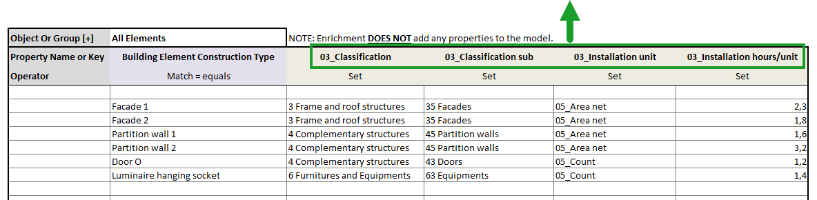

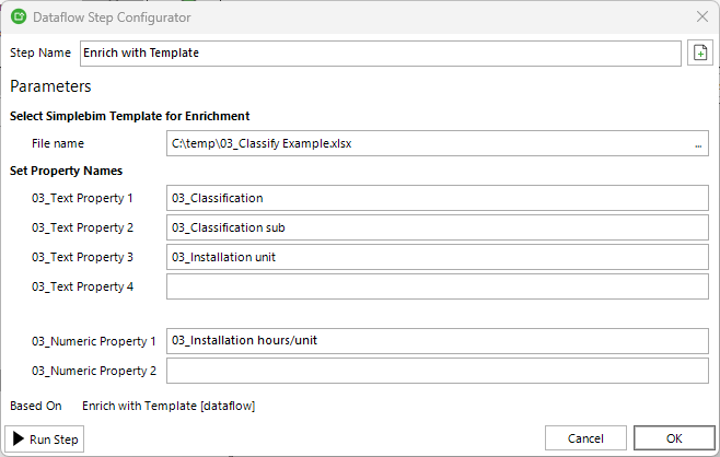

Image 1: Settings – Simplebim template file (Excel) with enriched property names, copied to the dataflow text and numeric property fields.

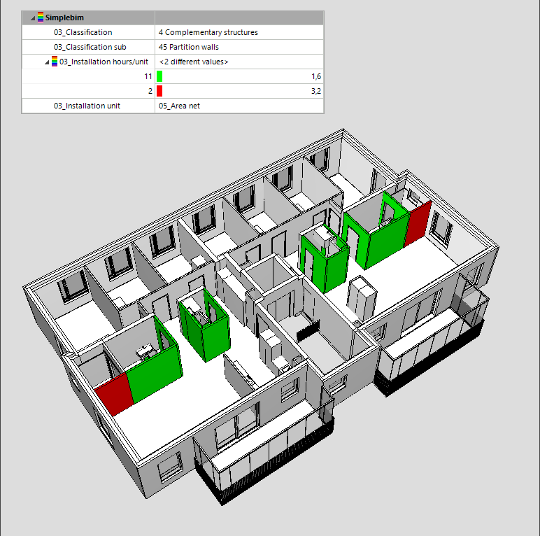

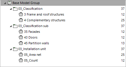

Image 2: End result – Objects automatically grouped by enriched text property values. Objects of one group selected in the model, with enriched properties visible in the property palette.

Select Simplebim Template for Enrichment
File Name
The name and path of the Simplebim Template file (Excel, .xlsx) from which the property values will be read and enriched to the base model objects.
Set Property Names
Base Model 03_Properties and assigned values will be automatically added to the Simplebim Property Set for the target objects.
03_Text Property 1
The name of the first text value property from the Simplebim template to be enriched. The property name must start with 03_.
03_Text Property 2
The name of the second text value property from the template to be enriched. The property name must start with 03_. This field is available when at least one text property has been defined.
03_Text Property 3
The name of the third text value property from the template to be enriched. The property name must start with 03_. This field is available when at least two text properties have been defined.
03_Text Property 4
The name of the fourth text value property from the template to be enriched. The property name must start with 03_. This field is available when at least three text properties have been defined.
03_Numeric Property 1
The name of the first numeric value property from the Simplebim template to be enriched. The property name must start with 03_.
03_Numeric Property 2
The name of the second numeric value property from the template to be enriched. The property name must start with 03_. This field is available when at least one numeric property has been defined.
03_Numeric Property 3
The name of the third numeric value property from the template to be enriched. The property name must start with 03_. This field is available when at least two numeric properties have been defined.
03_Numeric Property 4
The name of the fourth numeric value property from the template to be enriched. The property name must start with 03_. This field is available when at least three numeric properties have been defined.

    Where can I download or get the Enrich Excel template? As I understand, it is lighter than the old times template?
    Hi Taavi,
    It's the same Excel template as before, but you only need the Enrichment sheet. I've simply hidden the other sheets.
