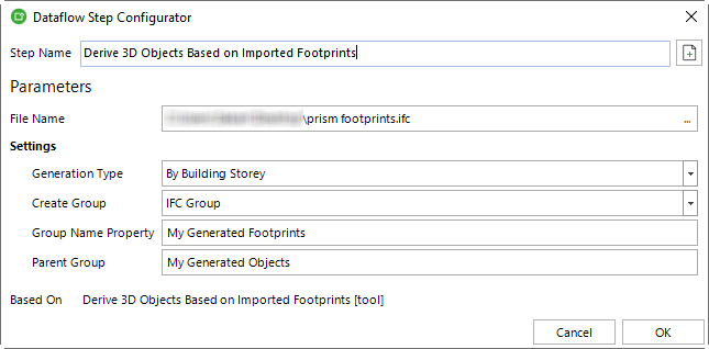

File Name
The full path and name, including the file extension, for the IFC file, that contains the 3D footprint objects.
Generation Type
Defines whether the prisms are generated per building (from bottom to the top of the building), or per building storey (from bottom to the top of each building storey).
By Building Storey
Generate location prisms per building storey.
By Building
Generate location prisms per building.
Create Group
Defines whether to create a group for the generated objects. The group is a convenient way to find the objects afterwards. It is also useful in dataflows to further process the location prisms in the following steps.
No
No group is created.
Generic Group
A group is created in the Generic Group category.
IFC Group
A group is created in the IFC Group category.
Group Name Property
Defines the name of the group.
Parent Group
Defines the name of the parent group. Groups can be hierarchical. If you already have a parent group in the model where you want to assign your new group. Define it here.
