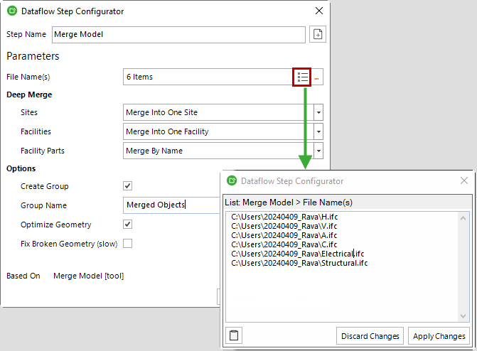

File Name(s)
Defines one or more IFC files to merge into the current model. The files are defined with full path and name, including the file extension. Type in a file name, or use the list editor to add multiple ones. Or you can click on the three dots and select the models using the Select Files Dialog.
‘Current model’ means the model that is currently open in Simplebim. The current model may be a single model or it may already have sub-models.

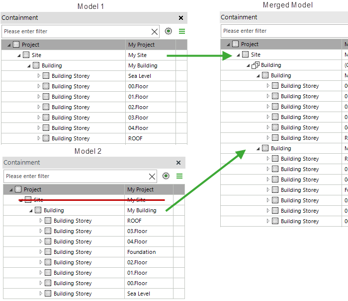

Sites
Defines how the site objects in the model tree (containment) of the models are merged.
Don't Merge
Don't merge sites. This also means, that nothing assigned to the sites is merged either.
Nothing has been merged. Everything has been moved to the common project.
Merge Into One Site
The resulting model should have only one site. Note however, that nothing assigned to the sites is merged, if not explicitly defined with the Facilities and Facility Parts settings.
Sites have been merged. The buildings have been moved to the site.

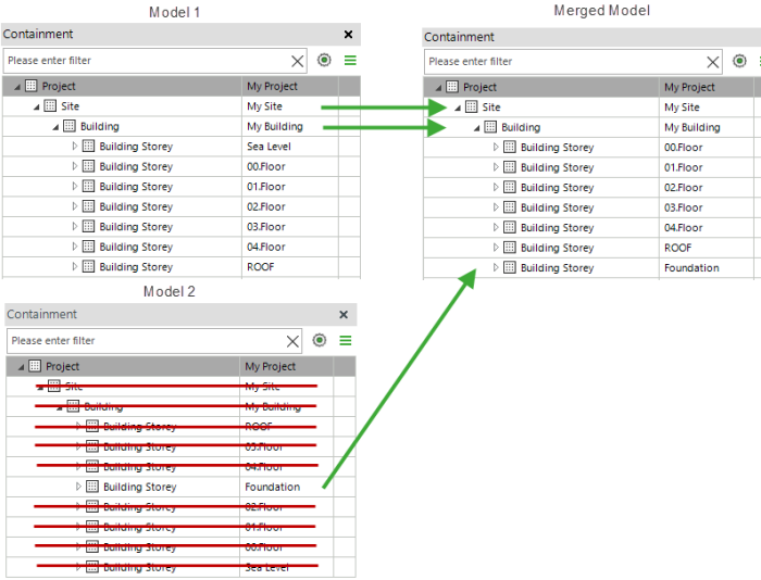

Facilities
Defines how the facility objects in the model tree (containment) of the models are merged. In the building models, the most common facility object is a building. In infra models you have other facilities you can merge. This option is available, if you are merging sites.
Don't Merge
Don't merge facilities. See the picture under the Sites setting.
Merge Into One Facility
The resulting model should have only one facility under each Site.
Sites and building have been merged. The building storeys have been moved under the merged building.
Merge By Name
Merge facilities by name. Only the facilities with the matching name are merged.
Facility Parts
Defines how the facility part objects in the model tree (containment) of the models are merged. In the building models, the most common facility part object is a building storey. In infra models you have other facility part you can merge. This setting is available, if you are merging Facilities.
Don't Merge
Don't merge facility parts. See the picture under the Facilities setting.
Merge By Name
Merge facility parts by name. Only the facility parts with the matching name are merged.
Facility Parts (building storeys) are merged, if they have the same name.
