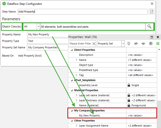

Defines the object classes to which the property is added. The object classes must be defined, because in IFC, the properties are defined for object classes. However, the object classes can have the same properties.
The special option All will process all the object classes, including the spatial containers (project, site, building, and building storey).
To target the operation more precisely, choose one object class or many from a list.

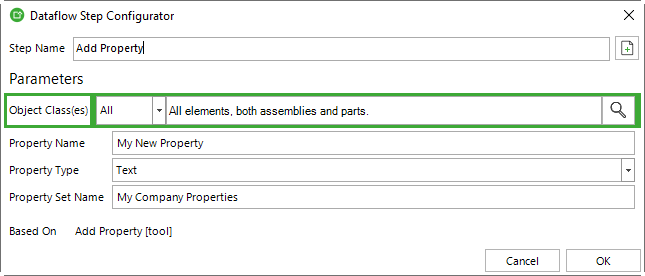

Property Name
Defines the property that is added.
Property Type
Defines which kind of property you want to create.
Different available property types are the following: Date, Date Time, Number, Text, Time of Day, Whole Number, Yes/No, Angle Measure, Area Measure, Count Measure, Electric Current Measure, Force Measure, Length Measure, Linear Velocity Measure, Mass Measure, Monetary Measure, Other Measure, Power Measure, Pressure Measure, Sound Pressure Measure, Temperature Measure, Thermal Transmittance Measure, Time Measure, Volume Measure, Volumetric Flowrate Measure.
Property Set Name
Defines the Property Set Name where the Property is created.
If the property set already exists in the model, then the property is added to the existing one. If the property set is not yet in the model, it is created.

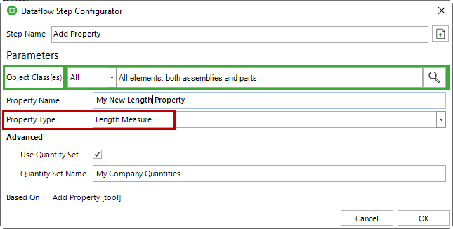

Use Quantity Set
Defines whether you want to create a Quantity Set instead of Property Set. Quantity sets are a special property set type in IFC, that can only include measure values. This option is available when you have chosen a measure type, for example, Length, Area, or Volume Measure, as your Property Type.
Quantity Set Name
Defines the Quantity Set Name where the Property is created.
If the quantity set already exists in the model, then the property is added to the existing one. If the quantity set is not yet in the model, it is created.
