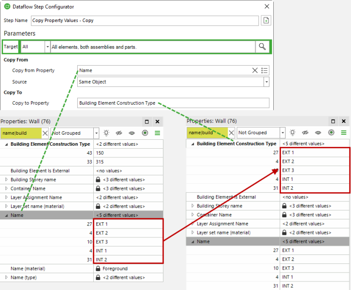

The Copy Property Values tool copies property values from one property to another. The basic usage is to copy values from one property to another within one object.
Copy a property value from the same object.

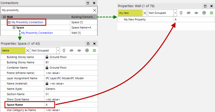

The more advanced possibility is to copy data from a connected object.
Copy a property value from connected object.

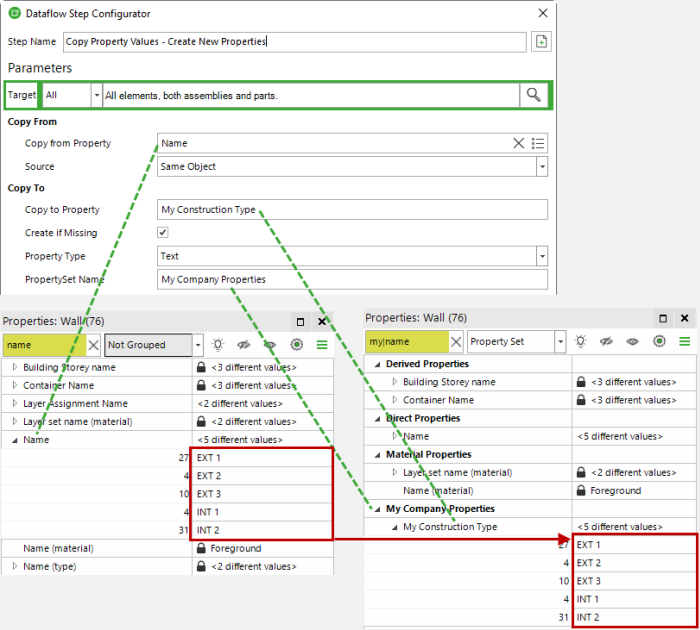

A basic data processing operation is to normalize the data structure. This means that you make sure that the relevant data is always in the same place in the model. No matter where it comes from. For all models, in every project and from all design disciplines. Copy Property Values is the key tool for doing data structure normalization.
Normalizing data structure by copying data to your own properties.

Copy from Property
Defines the name or identity key of the property from which you want to copy the values. This can be a property of the same object or a connected object.

Connection Name
The object can be connected to other objects via many different connection properties. You need to define, which connection property you want to use. For example My Proximity Connection copies property values from the object connected to the Target via My Proximity Connection connection.
Copying done using a connection property.

Copy to Property
Defines the name or identity key of the property into which you want to copy the values.
Create if Missing
Should the 'Copy to Property' be created to the model if it is missing? Creating the property while copying, will save you the trouble of creating it separately with the Add Property tool. Then again sometimes you will have the property already in the model, so you don't have to create it.
Property Type
This option is available when you have turned Create if Missing ON.
Defines which kind of property you want to create. By default you want to keep the from and to property types the same. However it is possible to copy to a different type of property. This requires that the conversion can be done. For example, all the property types can be converted and copied to a text property.
Different available property types are the following: Date, Date Time, Number, Text, Time of Day, Whole Number, Yes/No, Angle Measure, Area Measure, Count Measure, Electric Current Measure, Force Measure, Length Measure, Linear Velocity Measure, Mass Measure, Monetary Measure, Other Measure, Power Measure, Pressure Measure, Sound Pressure Measure, Temperature Measure, Thermal Transmittance Measure, Time Measure, Volume Measure, Volumetric Flowrate Measure.
PropertySet Name
The name of the property set where you want to create the missing property. If the property set already exists in the model, then the property is created to the existing one. If the property set is not yet in the model, it is created.
