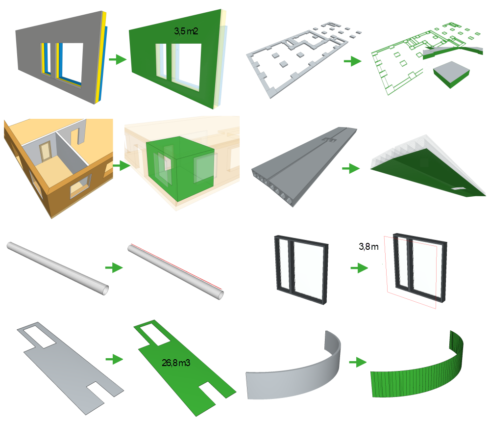

Simplebim calculates quantities based on the geometry of objects. Because of this, it doesn’t matter which model author tool was used for creating the models or who made them. Simplebim always calculates the quantities with the same logic in a consistent way. Thus, quantities are comparable between different models and even between different projects. In other words, Simplebim calculates standardized quantities.
Quantities are calculated both for object instances and container objects. For example, a wall can either be an instance with a single geometry or it can be an assembly with several child objects, each of which has its own geometry and thus also its own quantities.
Quantities can be calculated for objects from any object class. So the wall doesn’t have to be modeled as a wall, and you can still calculate the quantity you need for it.
There are six different tools for calculating quantities. They all share common settings, which you can find in the Calculate Quantities: Dimensions article.

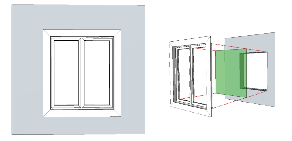

Opening elements are a special feature in BIM models. Usually, they are not explicitly visible in the viewers. The same applies to Simplebim. However, if they are in the IFC model, they can be used for quantity calculation. This depends on how the model is created in the model author tool.
Area Opening Element
The area of an opening element that is related to, for example, windows or doors. Note this can be different from the area of the actual product within the opening, for example, a window or door.
If you want to calculate the area of a window or door, use the Calculate Quantities: Shadow Areas tool and the Area Shadow Net instead. Which one you choose depends on whether you need to take into account the mounting allowance or not. Area Shadow does not take into account the mounting allowance. Area Opening Element does. Note whether or not these two are different, depends on how the model is created by the designer. Whether the designer has modeled the mounting allowance or not.

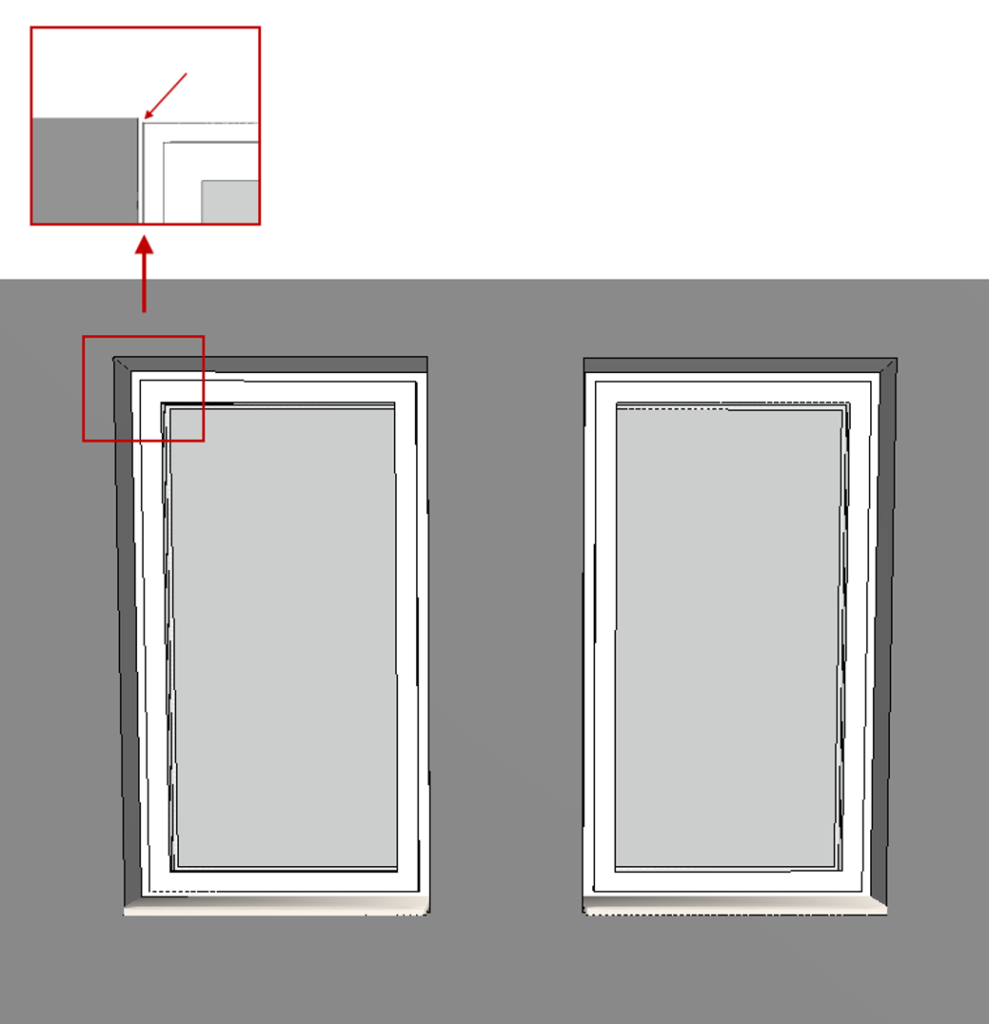

Dimension Height Opening
So-called fills, for example, doors and windows, have two different heights. One for the opening and one for the actual fill (product). To measure the fill height, use Height dimension of the Calculate Quantities: Dimensions tool. To measure the opening height, use Dimension Height Opening.
Whether these two are different depends on how the model is created. If the opening is modeled with the so-called mounting allowance, then these two dimensions are different. In this case, you can choose the one you need for your QTO.
Dimension Width Opening
So-called fills, for example, doors and windows, have two different widths. One for the opening and one for the actual fill (product). To measure the fill width, use the Shortest dimension of the Calculate Quantities: Dimensions tool. To measure the opening width, use the Dimension Width Opening.
