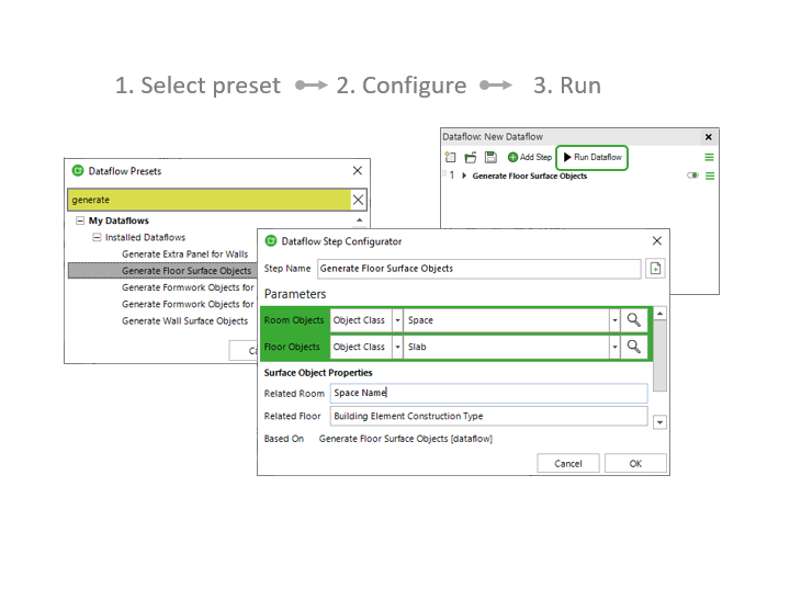

You can create dataflows from scratch, but the easiest way to get started is to use ready-made dataflows. You simply select a preset, configure it, and run it.
Using ready-made dataflows is an easy way to start.

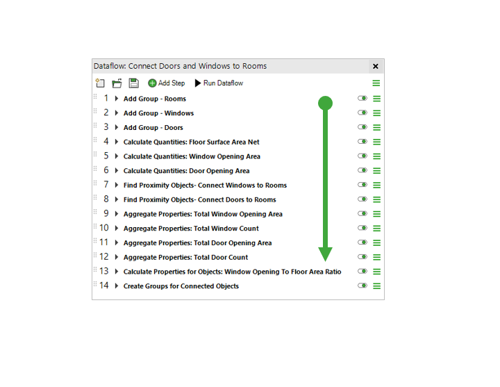

Dataflows are made up of steps
Dataflows are made up of steps. A step can contain a Simplebim tool or another dataflow. There are many different kinds of tools you can use. A tool can exclude objects and properties from the model. It can calculate quantities for objects, like areas or volumes. It can calculate new measures with formulas. It can colorize objects. It can find objects based on their proximity. And much more.
There are 100+ ways to process data in Simplebim. A dataflow runs the steps in order. You can combine them anyway you like. The possibilities are endless.
Dataflows can have many steps. They are run in order.

Ready-made dataflows
You can create dataflows from scratch. However, an easy way to get started is to use one of the growing number of ready-made dataflows. Simplebim includes ready-made dataflows for calculating basic quantities for the objects, adding elevation information, combining property values, excluding duplicates, generating objects for formwork or space surfaces, merging and managing building storeys, splitting the models and organizing the models into locations and more… There’s more to come. Stay tuned and updated. Check the ready-made dataflow documentation under the Using Simplebim - Dataflow - Descriptions category.

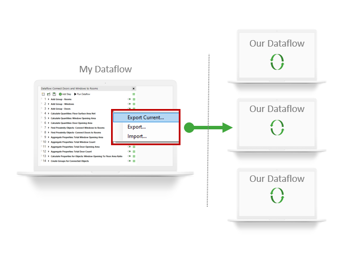

Reusing and sharing dataflows
The more use dataflows, the more value they produce. If you design and create them right, they can be reused, not just for updated models, but even in different projects and for models from all the different design disciples.
Dataflows are all about automation. They are meant to be reused and shared across the organization or even beyond.
Dataflows are meant to be reused and shared.
In Simplebim you share the dataflows by saving them into a special xml-files and then importing them back to Simplebim with just few clicks.
