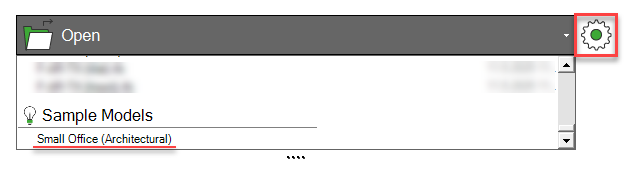

Startup window
The startup window has been re-designed because the old Excel templates will be replaced with dataflows. At the same time we removed some old annoyances, for example unified the Open and Import functionality. We also made some improvements, for example added a list of most recently used folders and added IFC import options. The sample IFC model is now always available under Sample Models.
If you are looking where to add new Excel templates you can find the same functionality in the new Dataflow palette.

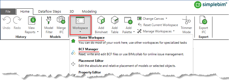

Ribbon Home tab
Because of  the new dataflows the automation group in the Home tab his gone and the functionality moved to the new Dataflow palette. Workspaces are now one button and the old Trimmer workspace is now the Home workspace. You will probably have much less need to change the workspace now that we introduced the Trimmer mode. This means that you can trim the model in any workspace and use the single-bucket-view in the Home workspace.
The BCF Manager workspace can now be found in the Workspace menu along with all other workspaces.

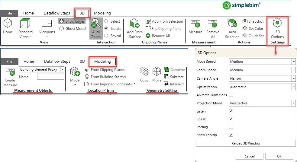

In the 3D window we moved the toolbar to the top (like in all other palettes) and improved the functionality.
The 3D ribbon had gotten too large, so we moved modelling measurements and the location prism modelling and geometry editing functionalities from the Location Editor workspace into a new Modelig ribbon tab. We also moved less used functionality under the 3D Options, which is the place to look if you are missing some functionality.

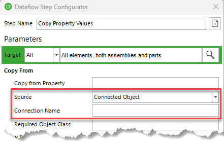

Connections palette
Many tools in Simplebim 11 create connections between objects. We already mentioned the Split Objects tool and the Proximity tool is another example. You can view these connections using the Connections palette. Then you can use the Copy Property Value tool for copying property values through the connections. Simply use ‘Connected Objects’ as the Source and the name of  the connection as the Connection Name.
