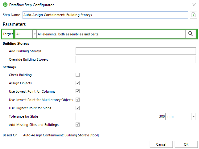

Target
Defines objects that are assigned to building storeys. Note that you can run the tool multiple times with different settings for different kinds of objects.
You can use the tool just to add empty building storeys to the model, or redefine the elevations of building storeys. In those cases target does not do anything, and you can leave it to the default setting.

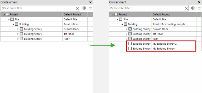

For example, the following value would add the buildings storeys to the model as shown in the picture:
name=My Building Storey 1;level=0|name=My Building Storey 2;level=3000

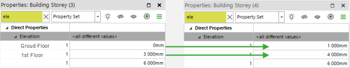

For example the following value will change the elevaltions of the existings building storeys as shown in the picture.
name=Ground Floor;level=1000|name=1st Floor;level=4000

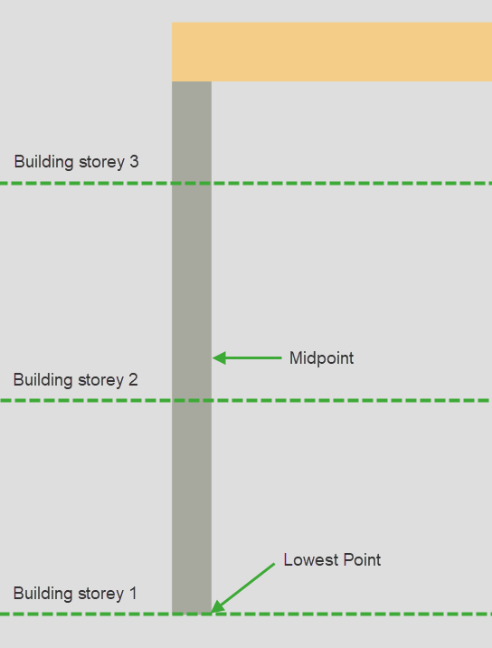

Use Lowest Point for Columns
Defines whether to use the lowest point for assigning columns. Otherwise, the geometric midpoint is used. This is useful, for example, with the structural model, where there can be column objects which extend through multiple building storeys.
This setting is used if the Assign Objects is on.
Use Lowest Point for Multi-storey Objects
Defines whether to use the lowest point for assigning multi-storey objects. Otherwise, the geometric midpoint is used. See the picture for the columns above.

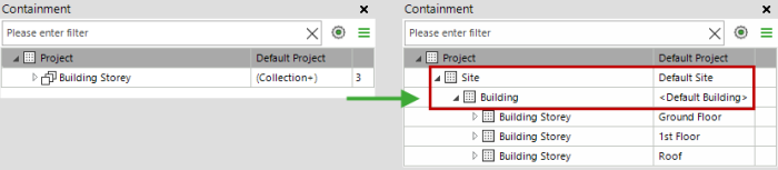

Add Missing Sites and Buildings
Defines whether to create the standard site-building structure if missing. Sometimes your model is missing the basic model tree structure. This setting enables you to define the default Site and Building to the model tree.
