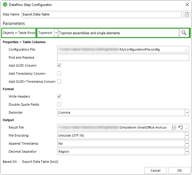

Objects = Table Rows
Defines the objects to be exported to the data table.

Configuration File
Defines the full path and name, including file extension, for the configuration file.
Type in the path and name, or click on the three dots to select the file with the File Selector dialog.
NOTE: The export will fail if this configuration is not given. In this case a message will be written into the log if logging is enabled.

Add GUID Column
Defines whether to add a GUID (Global ID) column as the first column.
Add Timestamp Column
Defines whether to add a Timestamp (date and time) column as the first column. The timestamp is the timestamp of the model.
Add GUID+Timestamp Column
Defines whether to add a first column that combines the GUID and the Timestamp.
Write Headers
Defines whether to write headers (property names) as the first row of the data table.
Double Quote Fields
Defines whether to wrap all values in double quotes. Some solutions that read CSV require this, others don't.
Delimiter
Defines the delimiter used for separating the fields. The delimiter you should use, depends on your downstream solution.

Result File
The full path and name of the file into which the data table is written.
File Encoding
Defines the encoding of the result file. Which one you should use, depends on your downstream solution.

Append Timestamp (to file name)
Defines whether to append a timestamp to the result file name. This is the timestamp of the model, not when the data table file was created. If you have a merged model, a separate data table file will be created for each model if they have different timestamps.

Decimal Separator
Defines the decimal separator for numeric values. Which one you should use, depends on your downstream solution.
