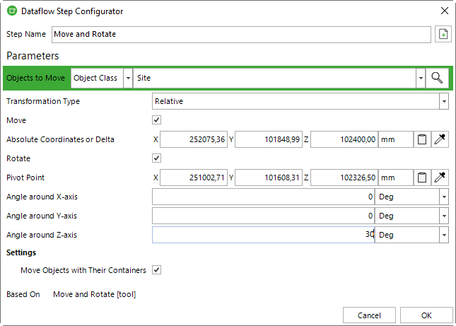

Objects to Move
Select Object Class, Group, Group Category, Top Most, or Part-level objects. If you input site objects, the site object's coordinate system is changed. If you input building elements, their coordinate system is changed.
Transformation Type
Relative
Moves objects relative to the current placement. Rotates objects relative to the current orientation.
Absolute
Moves objects to the given world coordinate system coordinates. Rotates the objects relative to the world coordinate system axis.
Move
You can use the tool for moving and/or rotating the objects. Set Move on, if you want to move the objects.
Absolute Coordinates or Delta
In the Relative mode, set the offset in all three main axes.
In the Absolute mode, set the world coordinates in all three axes.
You can type in the values, or paste them from a clipboard, or pick from the 3D. To pick the point from 3D, click on the pipette and then click a point from the 3D window.
Rotate
You can use the tool for moving and/or rotating the objects. Set Rotate on if you want to rotate the objects.
Pivot Point
Rotation is always done around a pivot point. Set it here.
Angle around X-axis
Rotation can be done around the main axes of the chosen objects' coordinate systems. Angle around the X-axis will rotate the objects around x-axis. Positive number does a counter-clockwise rotation.
Angle around Y-axis
Rotation can be done around the main axes of the chosen objects' coordinate systems. Angle around the Y-axis will rotate the objects around y-axis. Positive number does a counter-clockwise rotation.
Angle around Z-axis
Rotation can be done around the main axes of the chosen objects' coordinate systems. Angle around the Z-axis will rotate the objects around z-axis. Positive number does a counter-clockwise rotation.
Rotating around the Z-axis is the most common rotation you want to do, for example when changing the rotation of the site or project.
