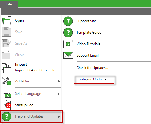

Each user can turn off Automatic Updates individually from within Simplebim. To do this, select Help and Updates from the File menu and then Configure Updates…

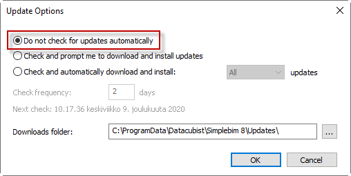

Select ‘Do not check for updates automatically’ in the Update Options dialog and click OK.
