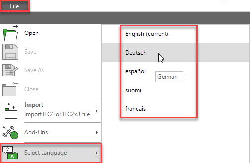

Selecting language from the user interface
From the File -menu select ‘Select Language’ and then the desired language.
Selecting Language
The language you choose will be used once you restart Simplebim.
