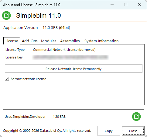

The license can also be borrowed on a computer and used offline. When the borrowed license is returned it is released on our license server. This can be used e.g. for ensuring that a license is available for a meeting or presentation. The license can be borrowed from the About dialog by checking the ‘Borrow network license’ checkbox. The license is returned by un-checking the same checkbox and closing Simplebim.
