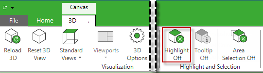

You can control the Select -functionality using the toggle button in the menu bar of the 3D window.
Older versions
Click on the ‘Highlight Off’ button in the 3D ribbon tab. The text will change to ‘Highlight On’ and drag&drop from the 3D window will start working normally again.
