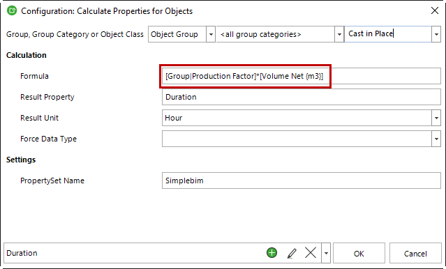

Use Formulas
Using formulas to derive new measure properties to the models is a powerful way to enrich data. This can be for example:
  • Calculating specific kinds of weights to the objects based on their volumes.
  • Derive new identifier based on multiple properties.
  • Or even calculating cost and working hours to the model objects based on their quantities.

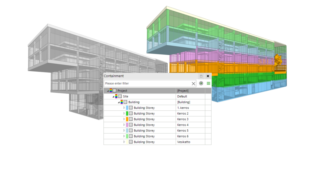

Organize Data Based on Locations
Locations are defined with 3D prisms.
In construction, everything happens in a location. You need to organize your objects and data locations, for example, for:
  • Cost estimation
  • Production planning and scheduling
  • Tendering
  • Procurement
  • Logistics
  • Design coordination
  • And so on…
The location information is not in the models you get from the designer by default, nor they should be. It would be madness to try to guide all different designers to add this information to the models. It is not information they produce. They don’t make these decisions. And the work would be done distributed, which is would be very inefficient. Organizing the data to locations in a centralized and automated way is the only rational and most efficient way to do this.
In Simplebim the locations are described by volumetric 3D objects. You can create the prisms either in Simplebim or some other application. You create them once and the same ones can then be used for organizing model data from all disciplines based on the locations. Or any model updates.
In practice, locations create a connection between the object representing locations and the building elements inside them. This connection can be used for copying and setting any information to the building elements based on the related location. Simplest way to use the connection is to copy the location identifiers like Section A, Building Storey 1 from the prism to the building elements.
There can be multiple ‘location systems’ in the models, for example…
  • Buildings
  • Sections
  • Building storeys
  • Concrete pours
  • Apartments
  • Spaces
  • Takt areas
  • With infra models the locations could be segments of the road or railways.

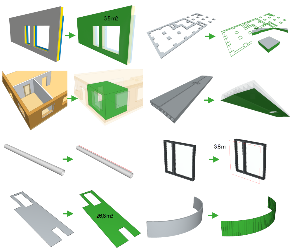

Derive Objects
One revolutionary way to enrich BIM data is to derive new objects and data to the models based on objects from the original, or a combination of original models.
Deriving new objects means adding new object to the models, based on the existing objects and their data. The derived objects are just like any original objects. They have geometry, properties and all other needed data structures. And they can of course be exported to IFC together with the original objects.
Surfaces
You can automatically generate new objects based on the object geometry’s surfaces. Top, bottom, sides, and even openings.
So why would you want to do this? Because not all objects that are needed, for example, in production are modeled by the designers.
A classic example of this is scheduling. Any given building element has multiple tasks associated with it, but the model only has one object to represent it. For example, a cast-in-place footings. There’s formwork, which usually doesn’t have a dedicated object in the model. There is reinforcement, which can, but many times and many states of the project, don’t have dedicated objects for it. How can one object, or data point, be many in the scheduling? Well, it cannot not. Not in an easy-to-manage way, anyway.
The very simple solution to this is to derive an object for each task from the original one.

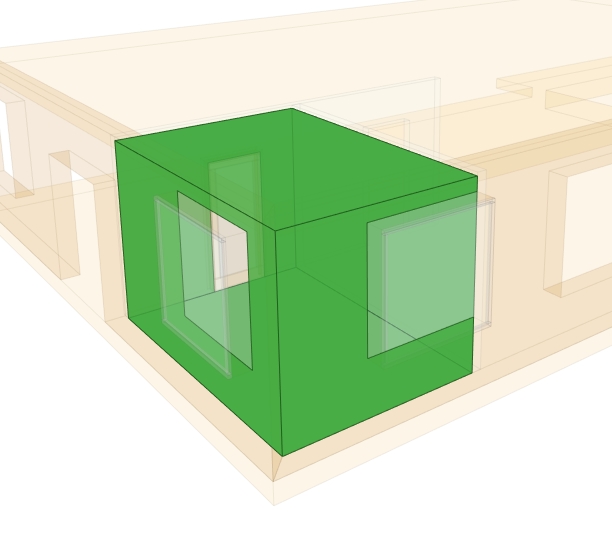

Space Surfaces
Derived space surface objects based on bounding walls.
Deriving new objects based on space surfaces and their bounding objects is an interesting possibility. The geometry is created based on the common area of the surface of the space and the surfaces of the bounding objects.
The derived surface objects not only have geometry, but they also have a connection to their parent objects, both the space and the building element. Through this connection, the space surfaces can inherit any information from the parents. This enables you to fully use the new objects in quantity take-off or the internal works, or in production planning and scheduling, both as a basis for the task estimation and 4D simulations.

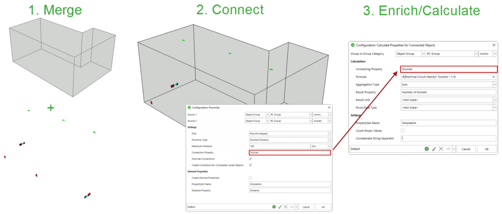

Create and Use Connections Between Building Elements
One of the most powerful ways to enrich BIM data is to create and use connections between building elements.
There are many kinds of connections and relations in BIM models, and there are many ways to use them. Some connections are already created in the model author tools. The walls might have a connection to the adjacent walls, or ducts from a ventilation system might be connected. These connections are between building elements of the same model.
Even more powerful connections can be created between building elements from multiple models from different disciplines. The easiest way to create the connections based on the geometric proxity of the objects. Simplebim has a very powerful tool for doing this.
Once the connections have been created there are many ways to use them to enrich model data, and countless use cases for this kind of enriched data. The connections can be used for message passing, in other words to exchange or copying data between the connected objects. They can also be used for organizing the data into groups.
Enriching data with the help of connections opens up a whole new range of practical applications for BIM data. Here are some use cases we have come across so far:
