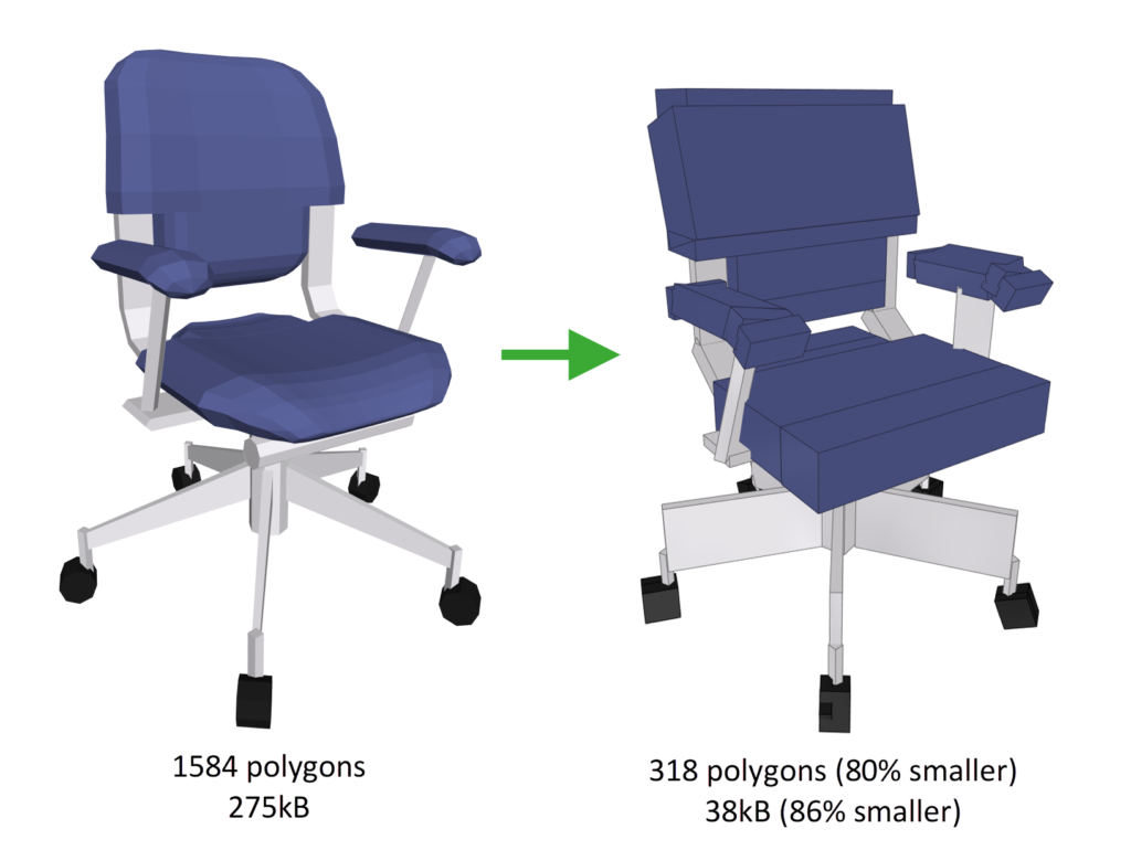

Simplify Geometry
Extra details in the model geometry are useful for architectural visualization, but not always downstream. The extra details can mean unnecessarily long upload and download times. The models can become too heavy to use in a chosen BIM viewer or tool. Usually, you cannot go back to the model author tools and simplify the geometry. Only you, as the model user, know what should be simplified. Simplebim allows you to simplify geometries in various ways.
Reduce file sizes by removing unnecessary geometry details and reduce the file sizes upto 90%.

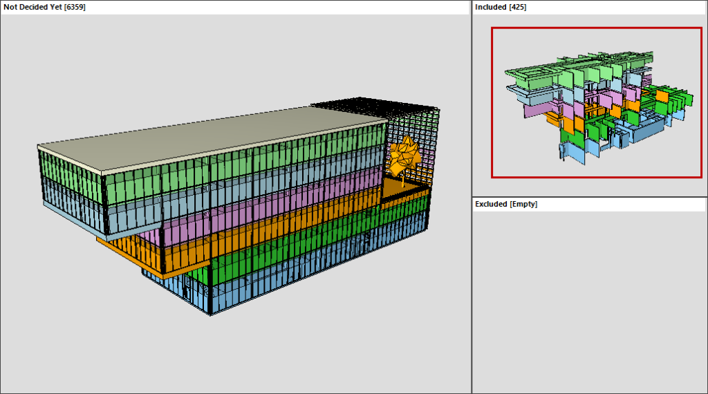

Trim and Remove Data
Model trimming is one of the unique core features of Simplebim. When you trim the model you loose information on purpose and you can have many good reasons for doing this.
  • When you are the model author you will want to trim away all data that you don’t want to share with others. BIM authoring applications let you do this to some extent, but with Simplebim you have much better control and visual feedback – and thus confidence in the models you share.
  • When you receive models, you know what data is important to you and you can remove everything else. Unnecessary data just causes unnecessary problems.
  • Removing extra and redundant information makes data more reliable to use.
  • Removing unnecessary data makes the whole BIM process smoother: moving data over the internet, storing the data, importing and using the data in other applications.
The basic trimming in Simplebim involves which objects and properties are included and which are excluded. Only the included objects and properties are exported to IFC. If you are for example an structural engineer, you can trim all of our 100 chairs from the model, which reduces their ‘weight’ in the model to zero.
You can also remove unnecessary classifications, groups and type objects from the model. When you for example determine that a classification in the model is incomplete or otherwise not trustworthy, you should simply remove it to make sure nobody in your organization can use it by mistake.
How to trim models in Simplebim is described in detail here.
