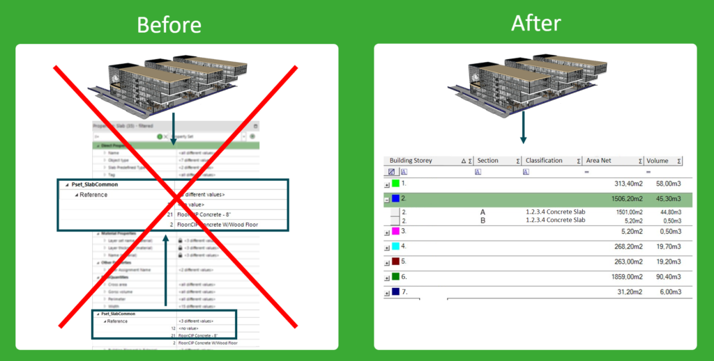

Structuring and normalizing data enables scalable use of BIM data.
Structuring data makes it easier to use.
  • You can create ready-made views and reports for the data that can be used for any model, model update, or project.
  • Automated analysis and simulation become possible because the data is always the same. You only need the create one set of rules for your automation.
  • Ultimately, consistently structured data can be used in analysis across the projects for the whole portfolio of projects, or even with AI.

Mapping Data
Once you have a consistent data structure for your models, you can start mapping data to it. In practice, the same data from different disciplines, model author tools, and companies are not on the same properties. To get a consistent result, the data needs to be mapped. In Simplebim, this can be done either manually or automatically with dataflows based on rules.

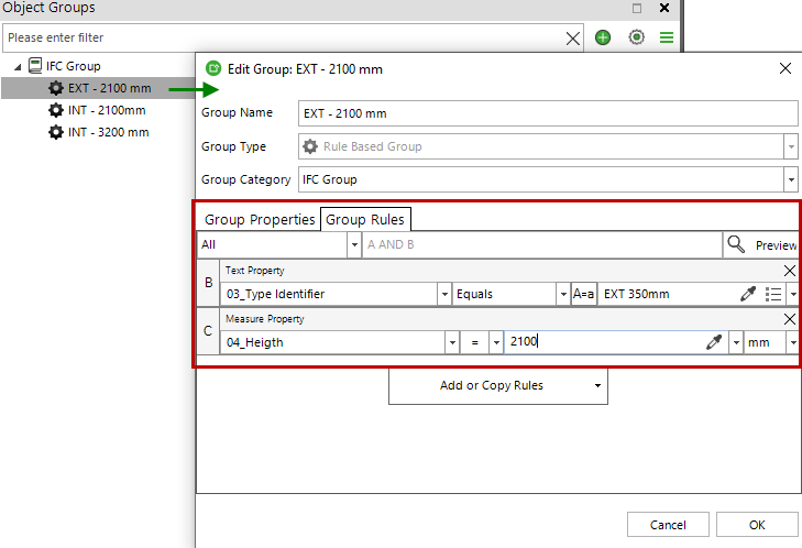

Groups and Classification Systems

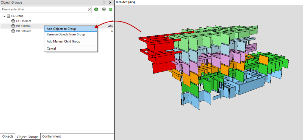

Manual grouping from 3D.
The first thing you probably think about when you hear the word classify is some sort of classification system like Uniformat and Uniclass, or TALO80 here in Finland. However, classification needs are many and they are everywhere. No one classification system serves all the purposes. Classifications are everywhere in the data.
For example. Separating cast-in-place building elements from the precast elements is a classification. Listing building elements and their quantities based on their material is a classification. Grouping the data further for scheduling based on associated tasks is a classification. Finding the building envelope separate from the interior walls and slabs for energy analysis is a classification. Grouping precast elements based on their height, because they need to be built in different factories, is a classification. You get the point.
In practice, it is impossible for architects and engineers to set all the classifications to the models that are needed downstream. The groups and classifications needed must be created in the data processing.
Rule based grouping in Simplebim.
Labeling, grouping, and classifying objects, or organizing data, is an important part of any downstream data usage. Grouping objects is also an important skill also when creating dataflows. Every dataflow has a target, the group of objects it will process.
